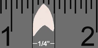

Directions......... Copy and print scan provided and make sure it's copied at proper REAL size. (use the ruler on the scan to help make size as true as possible)
After size is near perfect, CAREFULLY cut out insignia with scissors. (note, insignia has slightly rounded swooping edges and sides) Do not cut with square edges. Lay cut out pattern on foil FACE UP. Trace pattern on foil using pencil. Put double-sided tape on opposite (back-side) of foil where insignia is. Cut out foil on the trace line CAREFULLY.
