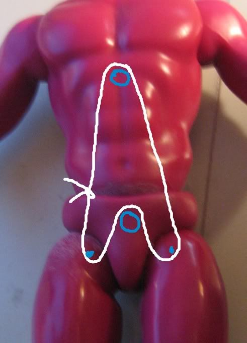

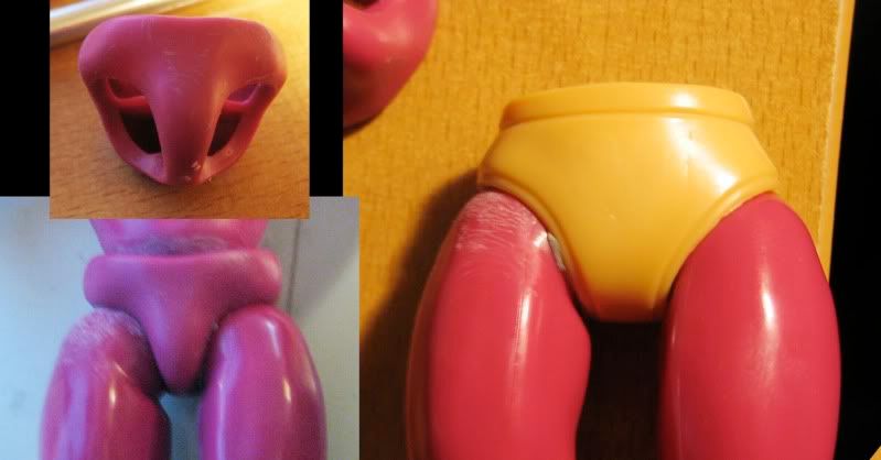

    Hello and thank you for this opportunity,
    I would like to first state that I like the Mattel retro body. I feel the anatomy and muscles look great in and out of costume. There have been complaints about bow-legs and thunder thighs, however I have no problem with that. The addition of a bicep swivel would be the icing on the cake in my opinion. Not necessary, but very cool.
    The problem with the body is due to 1 (and sort of 2) part: The pelvis.

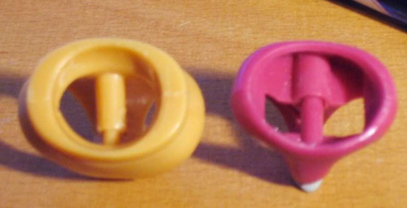

    Here is the top view of both an original pelvis (or in this case a Doc Mego one) and a Mattel pelvis, which is the one on the right. Notice the opening at the top. The Mego one is perfectly round as well as deep. It provides a perfect seat for the torso and because of it's completely round shape, the tension of the elastic doesn't pull it in any direction but down. This type of ball joint construction is very common with 70's figures such as GIJoe, Big Jim, and of course Mego.
    Notice the shape of the Mattel pelvis:
    I've drawn a circle around both parts to show the difference. The Mattel pelvis is oval shaped and shallow. The bottom of the torso isn't able to seat in it properly and the results are either the figure being pulled backwards or slumped forward. This is because the narrower sections of the oval shape have the least resistance to the elastic.

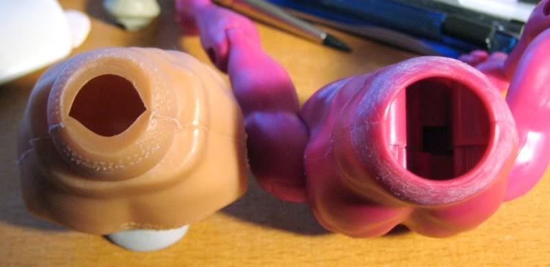

    Here are two images of the bottom of the torso:
    I've drawn circles again. The Mego torso is perfectly round, as well as textured, and the Mattel torso is oval shaped, despite the opening at the bottom being round. A change to the top of the pelvis and the bottom of the torso to make a good connection is what is needed to keep the waist from slipping around.
    On to the hip connections: Again, the pelvis is the problem here. The sockets are too shallow allowing for the hips to slip around easily.
    Here is a shot of the Mattel pelvis, the pelvis with legs, and the Mego pelvis with Mattel legs.
    The Mattel legs have nice ball joints on top. Notice how well they seat into the Mego pelvis. With elastic pressure, they pose well, hold position well, and I feel they even look better. So, just like with the waist, the seat for the hip joints need to be deep enough to hold the hips in place.
    I did string this together to see how it would work:
    The legs worked great, however the oval nature of the torso made it unable to seat in the pelvis.
    Speaking of elastic pressure, i have a suggestion for how they should be strung:
    The elastic goes down into the hip, over the peg in the pelvis, down into the other hip, over the peg in the torso, and tied at the waist. The upward pulling on the legs makes them sit better.
    If retooling is out of the question, I have had a fair amount of success adding gaskets to the joints. It's still not perfect, but they at least stand up straight.
    In the end, I'd like to see retro figures have a nice long life. Thank you again.
    Leave a comment:
