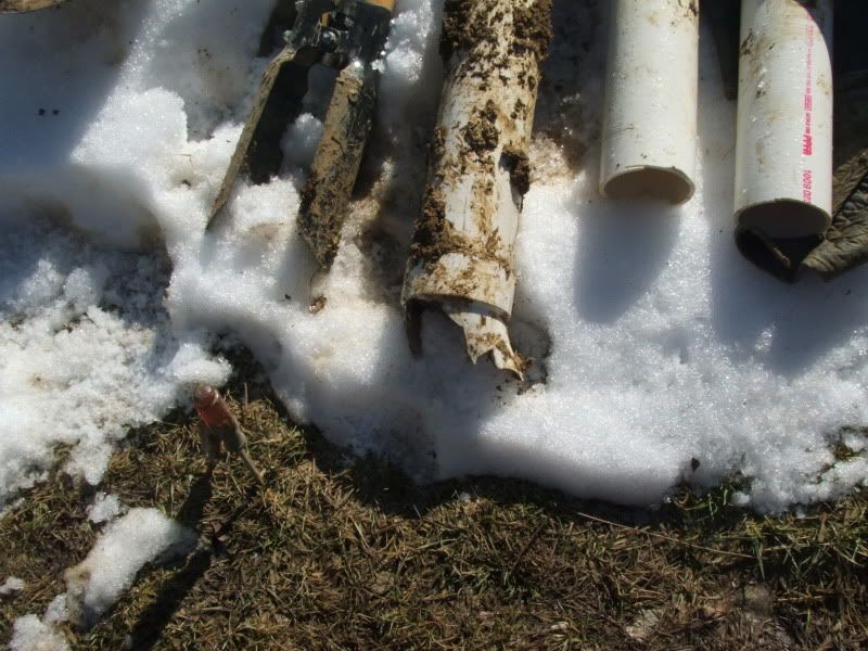

    Well I had a simple clog in the pipe. It backed up into my shop.
    I decide it would be easeyer to pay someone to clean it out so I could keep on working in the shop. Big mistake...I call roto ruter,,,I tell them I think its a simple clog of papaer....they disagree ofcourse..and this idiot uses a argressive cable for roots. I said I think thats a bad idea it will break the pipe.
    Well long story short ,they broke the pipe. Rather than argue with them I said dude just leve and thanks for the headace. I paid 200.00 for this.

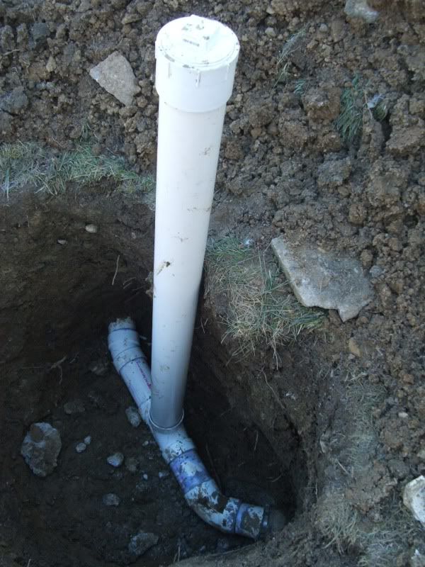

    Now we are cuttign up the floor in the basement and installing new pipe. I just dup up the sewer line out side and fixed it too. If I didn't own a concrete company and didn't know how too and have the tools too. This incedent would have cost 3000.00 at least if I came to fix it for a customer. This is what happenes when you dont unclog the pipes yourself. I have learned my lesson. I will now never hire anyone to do anything again. A snake costs 50.00 to rent roto ruter costs 3000.00 if they screw it up. thanks roto ruter your the best.
    It might not look like it but that hole is about 6 by 6 and was full of sewage when we started digging it. I was a very unhappy camper.
    I have been in construction for at least 20 years and I have dug up at least a thousand pipes and fixed them. I know what a pipe that has had a cutting bit destroy looks like. And thats adzactly what I found when I dug it up. I knew it would be right where the T was. It allows slack in the bit and blows it apart everytime. Thats why you start off easy and get more agressive bits out if needed. You dont start off like a nut job ramming a agressive bit unless your in a hurry and want to get to the next job. If thats the case please skip me and by all means go destroy someone leses sewer line.

        Permit...lol no I can't wait 2 weeks for that. But I do work for the city they know me pretty well. I'm sure they will ok me. I reshaped the whole farm with a dozer not to long ago and put in colbert pipes. They said Chris could you at least let us know what your doing from time to time...lol But I will be back filling with gravel, 2 ft around pipe, then dirt. Unlike the retards that did the original line. Why they refuse to use gravel is beyound me. I'm going to get a load in the dump truck this week to back fill with. I like to surround the pipe in pete gravle but a lot of guys just toss in dirt and think thats ok. Remeber when you hire someone you get what you pay for. I am not the cheepest concrete guy but we do the best work,and we do it right. We always put in stable subgrade compacted in lifts with rebar tied and drilled on center and I only use high grade 4000 mix. Then I always use a high grade sealer to protect the surface . But a lot of guys don't. Drives me crazy bidding aginst them. They dont pay taxes,they dont have a licence,they dont have insurance. I cant give as cheep of a price and still do the job right. Your concrete is only as good as the subgrade. I Dig it out till I hit good ground then put in 6 10's compacted. God don't get me started...lol I hate hacks I could go on all day about the hacks around here.lol I couldnt beleve there was no gravel around the line when I dug it up.

          That's not the main line it's the feed from the house to the main line.I used a thicker pipe, the green stuff is too thin. I like to over kill the job.
          Yes it bites for sure but why argue with them It would take forever to get them to fix it. At least it wasnt clay pipe thank god. I had to tie to it but it was pvc the rest of the way. Clay pipe sucksssssssssssssssssssssssssss..lol

            terracotta sucks, but even some of that old cast iron pipe is nasty too.
            i've seen just one rock in the wrong spot while backfilling or settling crack a cast iron pipe.
            that's why its good to use sand-sand-sand on all occassions - including for pvc

                      Yeah your right about the sand,,we were just out there talking about that. Sand would be the best fill. I was going to use pete gravle but sand would be better. Yeah I know they don't give them any training and no time per job. So really it's not the techs fault. That's why I didn't say much to the guy after he bisted it. I figured it was an easy snake job but I knew ion the back of my mind the things you stated were true about no training and no time per job. So my fault really.

                          Good thing you decided against pea gravel
                          It makes for lousy compaction under the pipe - especially after time.
                          Sand is the best way to go and maybe throw a bucket or 2 of water in there to help compact it under the pipe if the sand is too dry.
                          Lastly, if you're supporting the pipe with bricks or rocks don't forget to take them out while backfilling under.
                          If you don't they make for a prefect spot for the pipe to bust when it settles.
