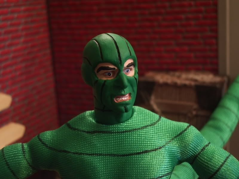

                  This is actually the head I'm using (this is before I...modified it) I think it is the Shade. i got it from Austin many moons ago. A lot of teeth on this guy...

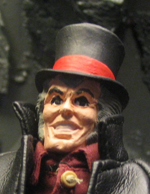

                        I haven't given up on this, I just couldn't wait to get a picture of Prof. Casket posted. I'm still tinkering.

                          Here's with his teeth painted flesh-tone and then dry-brushed white...(doesn't turn up in picture well.)
