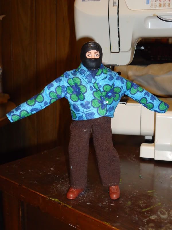

              I know, the sleeves need to be shorter. Since this is still a practice run, I'm not going to worry about them. I'm not entirely happy with the fit along the sides, especially where the armholes seem to stick out a little to far, causing the shoulders to hang low. There's also a lot of puckering around the neck and shoulders. Any suggestions what I could to fix that? Also, those little notches on the collar are going to take some practice. They are a huge pain in the butt!
              Anyhoo, here are pics. I'll take any suggestions I can get to make it fit better and more smoothly.

                del how does that pattern look when it's flat, particularly the notched collar? Sometimes you just have to notch the fabric right up to the seamline before you turn inside out to minimize puckering. But you have to do this carefully or you may cut the seam by accident or your seam could fall apart when you turn the fabric right side out. And the most important thing is you have to iron as you sew.
                I think the shoulder seams go out too far, but the bottom seam close to the waistline is fine. I would trim your pattern up by the shoulders but not at the waist and see if that fits better. Or, alternatively, you can turn your clothing inside out, place it back onto your figure, and then cut off the sleeves, cutting where your new seamline needs to be. Then, take apart your sewing and then redraw your pattern based on this new measurement.

                  Well, I finally got enough work done on this to post. I'm not sure how it fit on Ken, so maybe it's not designed to close in the front. I cut most of the pieces down by about 1/2", and I'm happy with the sizing everywhere except the front and the collar. I think if I leave the front at its original size, it will lay more like a double-breasted jacket, especially on the Stooges body I'm using for the Sandman. I just think the collar needs to be a tad wider so it doesn't seem so bulky when I topstitch and fold it out.
                  I also need to work on the notches at the lapels. I think this effort looks better than the previous ones by a long shot, but the stitching came undone on one side when I pulled the right side out. Maybe I just cut it too close.
                  As you can see, it could work for T1 bodies, if you don't need the jacket to close. I'll keep working at it and continue to update when I can.

                    I think I finally have a decent pattern for a double-breasted jacket, that will also fit a fat body. There are still a few puckers here and there, but I'm confident that this will work for some customs I have in the works. Next time, I might make the notches in the lapel a little lower and a little deeper, but I don't think think they look too bad here. The collar could be narrowed, depending on the style you're going for. This should also work for a waistcoat, if you make it without sleeves and shorten the bottom.

                      That looks really great Amy!!
