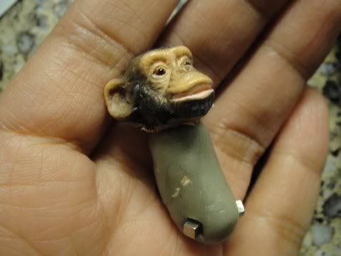

                  I poured some Mugato feet earlier with a whole magnet in each paw . Havent attatched a body yet.
                  Since we love molding so much < I wonder if theres a way to melt a metal pour it then magnetize it. ?

                              I put half a Neo Mag in the human feet : BUT on the Mugato feet I put a whole .
                              He cant really stick like my old Magnetic Batman . . . YET.
                              But . . . . . Spiderman doesnt HAVE ape feet.
