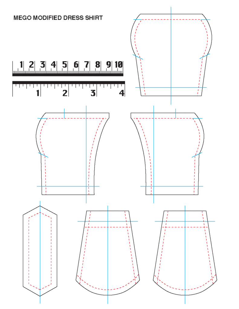

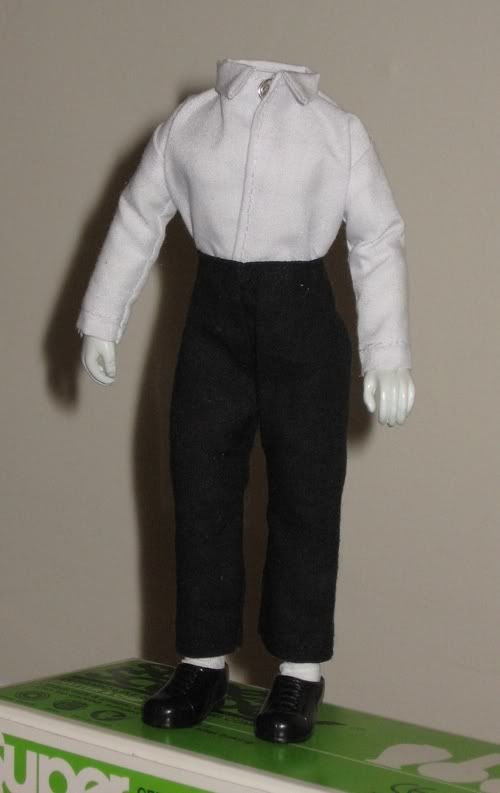

              Okay - after LOTS of trial and error I reverse engineered and modified a Doc Mego alter ego shirt and I think I came up with a pattern I'm pretty happy with.
              The main differences between this and the alter ego shirt are that it doesn't have separate pieces for the cuffs (I couldn't be bothered) and both sides of the collar meet in the front, like on a real dress shirt. (In the photo it's apart a bit, but that's 'cus he doesn't have a head or tie yet.)
              Also, the sleeves are a little bit longer so the cuffs can be seen under the jacket sleeves a bit. "Pop your cuffs" as Paulie Walnuts says!
              My sewing skills stink, and I'm not really sure how to draw up patterns - but here it is if someone else wants to give it a try! If you have any corrections or suggestions please let me know and I'll adjust the file.
              Also, if someone wants a higher res PDF or AI file, let me know!

                you didn't put any dimensions on diagram to verify the right size when printed out.
                • Brazoo
                  • Feb 14, 2009
                  • 4767
                  Oh - I didn't know that was necessary! Does it help that the sheet is exactly 8.5 X 11?
                  • Brazoo
                    • Feb 14, 2009
                    • 4767
                    Okay - I've updated the file with a scale for inches and cms.
                    Please let me know if you have any other suggestions!
