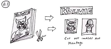

   One standby I love for making boxes is to first get my hands on several images of the character, such as old comics. This gets me to thinking about the design of the box, the color scheme, and also gives me some Lettering to use as the character's name sign on the box.

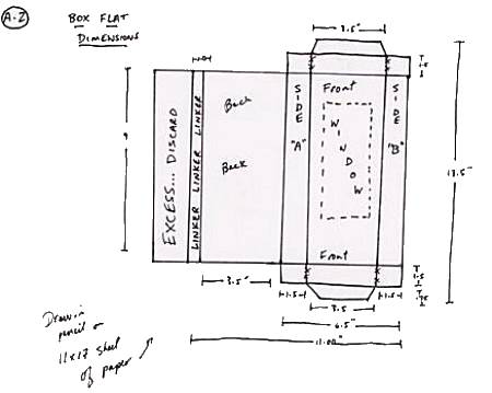

   The first thing you need to do to make a box is design a layout for the box, called a Flat. This is a pencil design of the dimensions of the unfolded box which you will design as a montage of images to adorn your box. Begin with a sheet of 11x17 paper and draw the pattern seen in (fig. A.2) with the exact dimensions seen there.

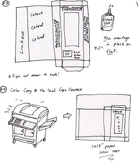

   Now start to paste your lettering and pictures into place on your box. Remember to leave the area of the window blank (if you have one). I tend to have the dimensions of my window be 2.5x6" and begin about 1" below to the top edge. I start by laying down sheets of construction paper in the base color I want, i.e. for my Flash box, I laid down pieces of red construction paper and pasted them in place. Then I glued the lettering on separately. Go wild with this! Don't let your imagination be constrained simply by what Mego did.
   Try thinking of a name for your toy line, and a logo.... Charlee Flatt used to call his the "Unofficial World's Greatest Super Heroes." I call mine "The Unsung Heroes Collection," as I frequently make characters whom I feel have not gotten adequate figure representation, and I call my villains "The Unsavory Villains Collection," since you can't really say, unsung villains now, can you?

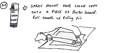

   Anyway, what can you come up with? Once you have glued in all of your box design articles (fig. A.3), take your box flat to your local copy center and get a 11x17 color copy made of it (fig. A.4). Using Spray Mount by 3M, mount your color copy onto a posterboard and cut out along the box lines (fig. A.5). Fold your box into shape but don't glue anything yet!
