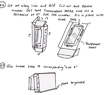

Cut out the window of the box using an X-Acto knife, and tape in a window made of some Transparency paper (fig. A.6). Fold the box into shape and glue it closed using Elmer's glue at the place where the "linker" section of the box, and box "side B" overlap, the "linker" goes on the inside (fig. A.7). Your box is now done!

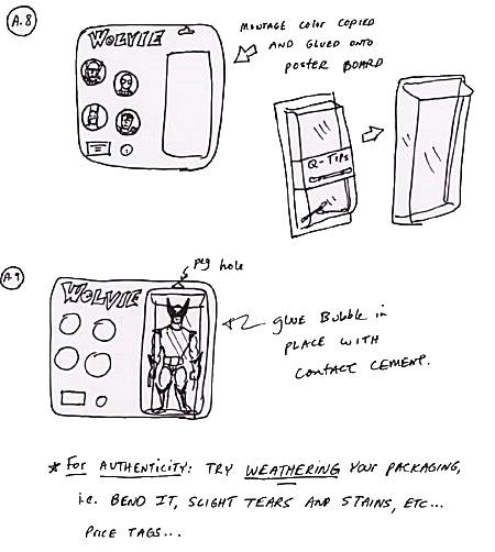

   This is actually a lot easier to make than a box. Simply design a flat in much the same way you would a box, but in the dimensions of the desired card packaging. make color copy and mount it onto posterboard as before. But now.... you need a bubble large enough for the figure to fit in. Well unless you have a real Mego card to cannibalize, you're outta luck. But wait! Don't despair yet! Can you think of any product you see I the drug store everyday that has a bubble similar in size and shape to a Mego figure bubble...
   Give up? Q-TIPS! I know... it seems unlikely, but I stumbled onto this idea one day at a flea market when, from a distance, a bunch of Q-tip boxes stacked on top of each other seemed like a bunch of action figures. I bought one, took it home, and sure enough, it was large enough to accommodate a Mego. However, you must make sure that the bubble is large enough-- many brands aren't. The kind I get are not actual Q-Tip brand (by Johnson and Johnson) rather a generic one I get at the everything's a buck store. Embarrassing as it may be, you might have to sneak a Mego into the store and hold it up against the bubble to see if it will fit (fig. A.8)
   So anyway, get your cotton swab box bubble, remove it from it's backing, store the swabs in a Zip-Lock baggy in the medicine drawer, and use some goof off to get the paper residue off the edges of the bubble. Now glue that sucker in place onto the card with the figure inside (fig. A.9).
