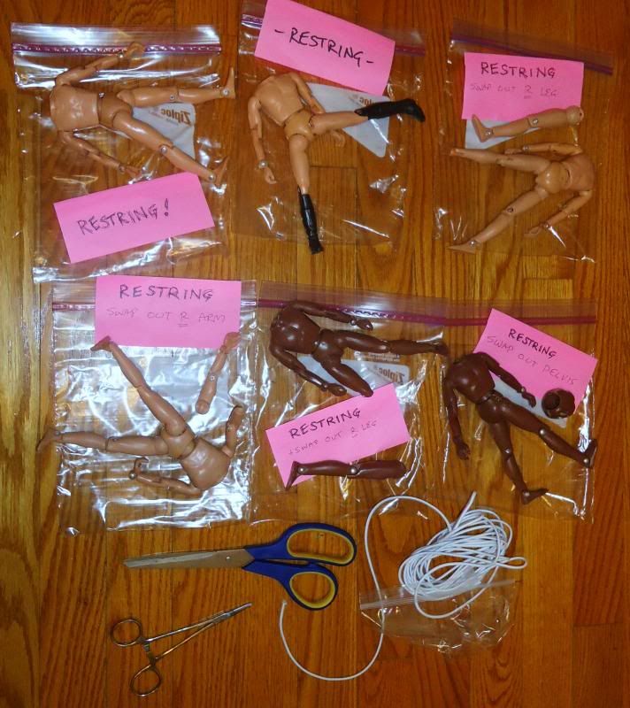

    As my Mego collection has slowly grown, I have been "trading up" various clothing and accessories in the attempt to "restore" some figures. That has included grabbing some eBay lots of heads (for instance) along with random loose limbs, and jumping on a broken-leg figure just for those pristine boots... etcetera. Obviously, this has resulted in a growing pile of broken bodies that could be useable by merely replacing a leg or arm.
    So... this past Saturday evening, I pulled out all the bodies and earmarked replacement parts whose repairs could be answered by restringing, along with a freshly-purchased 5 yards(!) of elastic, a pair of scissors and some hemostats. After one ridiculously simple repair, I decided to lay out the remaining figures awaiting restringing to grab a quick WIP photo --
    Only 45 minutes later, this was the result of my efforts.
    I cannot begin to express how incredibly delighted I am by taking so much potentially "useless garbage" and turning it all back into useable action figures!

      VERY NICE. Did you use the round elastic, or the flat elastic?

        Little tip...you can get rid of the 'spread eagle' look by going over the pelvic bar instead of straight across to the other leg. Nice work.
          Round elastic. The entire 5 yards (minus what I had just used in the first attempt) is shown in that first photo. but I realize its shape may not be completely evident.
          Yeah... I was wondering if that would have any effect, but I only noticed that bar on the second-to-last figure. The very last one did not have the bar.

            I came up with this method of restringing that gets rid of the spread legs and it will work even if there isn't any pelvis bar. http://megomuseum.com/community/show...618#post852618

              I will warn you,it becomes addictive after awhile. Any more,I'll buy Type 1s over Type 2s so I can re-string them.
