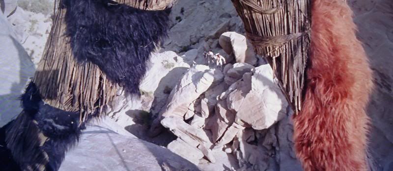

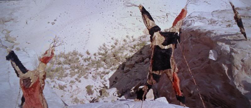

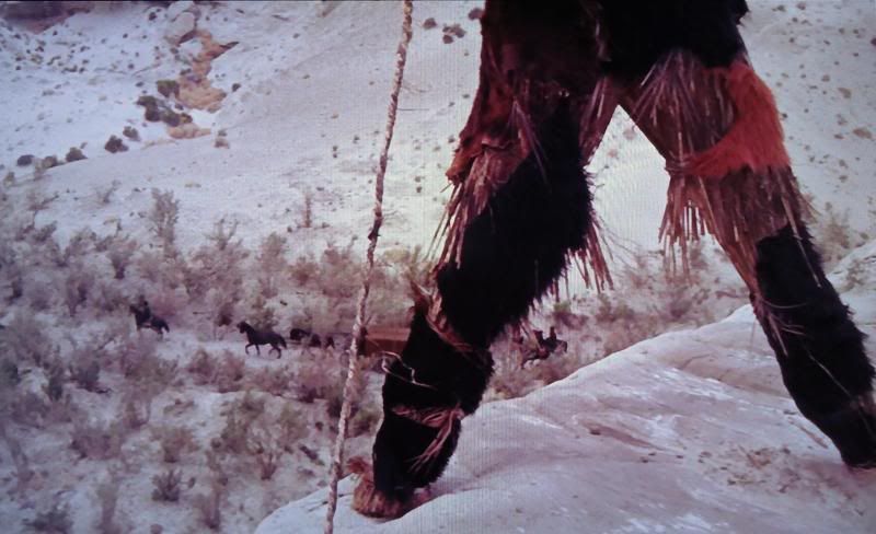

          The reference photos that I have been using for my assembly of PotA "Forbidden Zone Scarecrows" are Blu-Ray screen-grabs taken directly from the movie. I would enjoy seeing any other (non-screen) reference shots, but the brief movie close-ups leave no doubt whatsoever (IMHO) as to the basic construction of the scarecrows: bound sheaves of straw, covered with swatches of black, brown and orange fur.

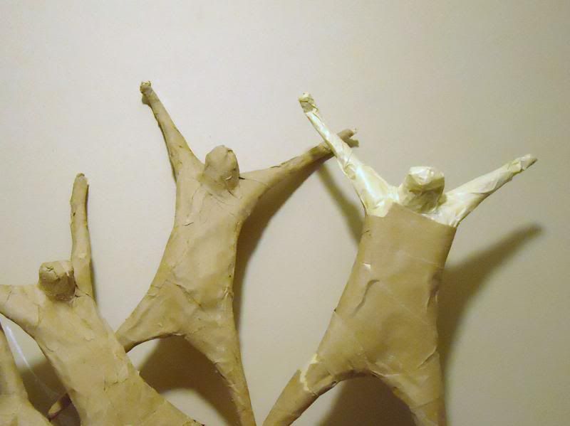

          While I had originally considered an "X" frame of sticks for this project, I decided to use something sturdier than wood; the use of heavy-gauge wire also provides me with bendable "feet" that can be driven into the ground for posing. This Spring, I finally removed a wire plant support that I have had in my garden for several years; it has been sitting aside for a few weeks, its thick gauge wire awaiting the start of this project.
          The skeleton for each Scarecrow is made of two wires, held in place by masking tape.
          I slowly built up of the bulk of the bodies by alternating layers of paper towels + wood glue with additional masking tape.
          I then covered the entirety of each body with torn strips of brown paper bag (the heavy bags from grocery stores) applied Papiér Mache-style with wood glue. This gave me a hardened substrate which would more easily accommodate application of virtually any additional materials.

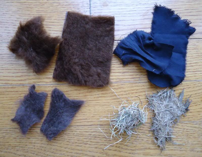

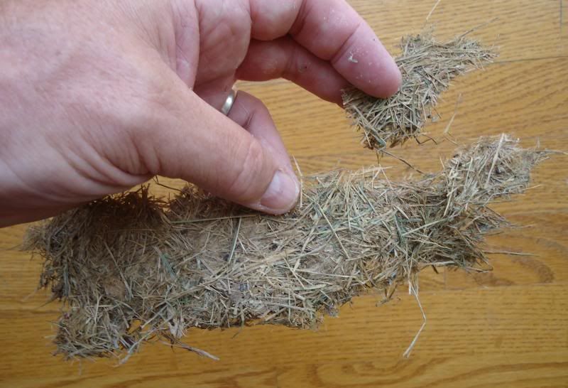

          Using the screen-grabbed photos as inspiration -- and employing a liberal amount of Artistic License -- I then covered the bodies in a random jigsaw pattern with a combination of materials that I already had around the house: short fake fur fabric, thick brown felt, black cotton fabric and dried grass. The two brown fabrics (fur + felt) were easily stressed by pulling apart fibers to lessen the appearance of woven fabric. The dried grass I collected from the edges of my lawn (the residue from having mowed the lawn a few days previous).
          Sheets of matted-together mowed/dried grass that had formed over several weeks along the edges of the sidewalk made this entire project much easier to accomplish, as I could cover large sections of the bodies at a time.

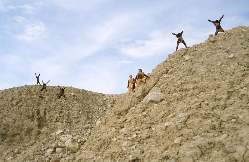

                  All things considered, I think these turned out pretty well...
                  "Oh, dear... THIS can't be good..."
                  "When in Ape City, be sure to visit the mysterious FORBIDDEN ZONE!"

                    A couple more...
                    "Hey, Alan... I think we were supposed to turn LEFT just past of Ape City."

                      The more sharp-eyed among you will notice I added neither guy ropes nor "twig hands" yet. It was either that, or take advantage of a narrow weather window to grab those pix. I chose the more entertaining option. When I upgrade the scarecrows, I will go back and set up some more shots -- this time including some reverse-angle ones.
                      In the meantime... I have other custom projects to tackle...
