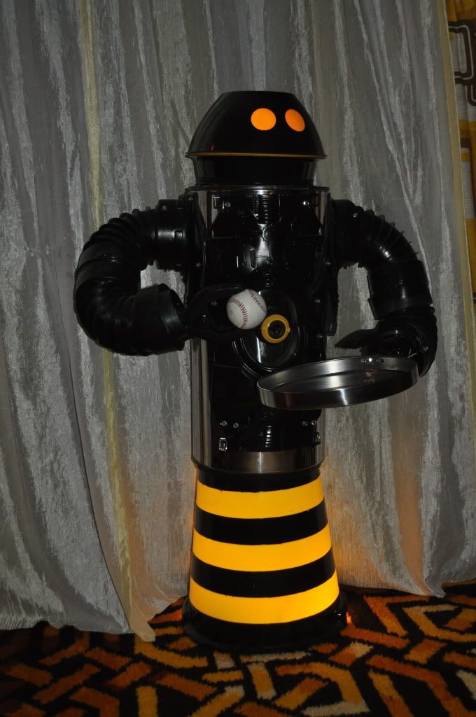

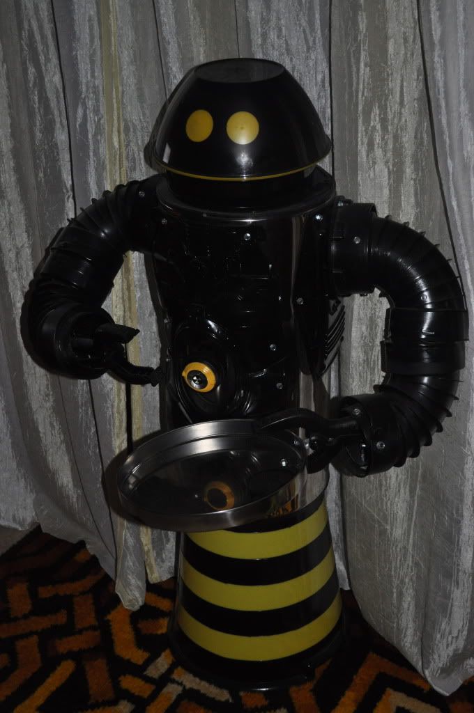

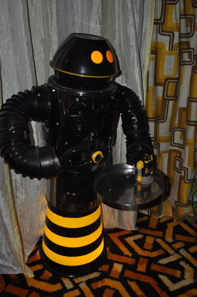

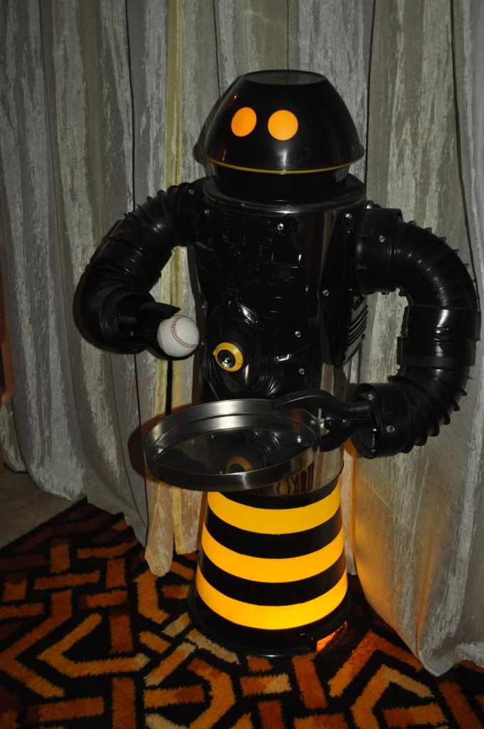

    This is not your typical custom action figure. I have a 6 year old son who love's robots. Last year for his birthday, I bought him the entire line of Ideals Robo-Force from 1983 which he plays with and loves to death so I took on kind of an ambitious project and decided to make a life sized one for him. I had an idea of how it would look and went to Home Depot and a few other stores and assembled this guy out of random parts I thought would work. In the end, I came up with the now finished almost 5 foot version. He took us a little over 2 weeks to put together and cost about $165 to make. He sits in my living room. His eyes and base are wired to light up (by using a remote control) and if you press the center button on his chest, he can talk and makes robot noises too. He's great at holding keys and sunglasses on his tray and whenever someone comes over, it's the first thing they notice. I guess it's kind of hard to ignore the 5 foot Robot in the room. We call him Bumblebot and these pics really don't do him justice as he's way cooler looking in person.
    To get the idea of his size, he's holding a baseball

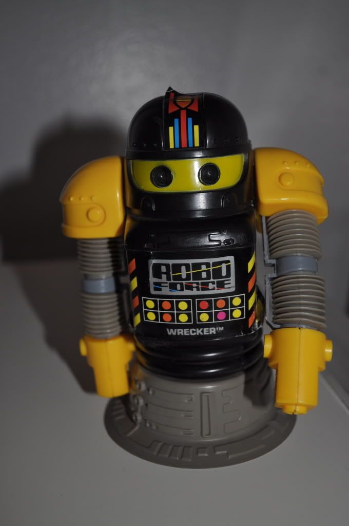

    Here he is with his inspiration on his tray: Wrecker from Robo-Force
    Lights off
    Best Glow In the Dark Feature Ever!
    He's always smiling
    The original Wrecker close up.

      Dad of the year! When you have time, I'd love to know how you pulled off the head dome and base. Did you find a couple of things in translucent yellow and then use black paint and masking? I've been toying with the idea of making my son a big Lego guy, but nothing so ambitious as yours.

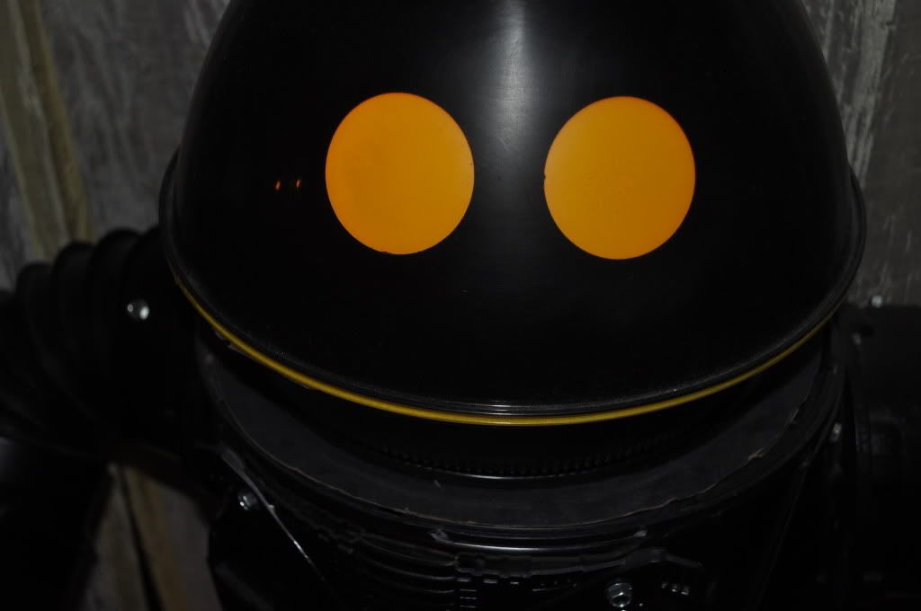

        Total accident. I was going to make the head all yellow at first. I found a clear dome that would make the perfect head I though it be neat if I could keep the eyes clear to let the light pass through and applied some round stickers first before spray-painting the head. It didn't work as whenever I removed the stickers, they would always take a bit of the paint around the edges with it and after 3 attempts and some wasted money, I gave up. Since yellow is a very unforgiving color to work with my second thought was to try and make the head darker so I did the same thing only with black spray-paint. Black hides all sins and it worked great. When I went to wire the lights I had mistakenly placed the black head over the yellow one that I was intending on throwing away but hadn't realized that the yellow head was underneath the black one until I screwed the head on. When I turned the light on, the yellow dome underneath reflected right through what was supposed to be clear eye holes on the black head. It made for such a cool effect, I decided to keep it. So it's basically two layers...a solid yellow part under the black dome and it was total accident I did it that way.
        As for the base, I always intended for that to light up the way it does. That's actually a stool from Ikea. It's molded in yellow and had that ribbed effect to it and I simply taped up every other yellow band and used plastic spray paint to get the black stripes. The black paint doesn't allow any light through but the yellow plastic does.
