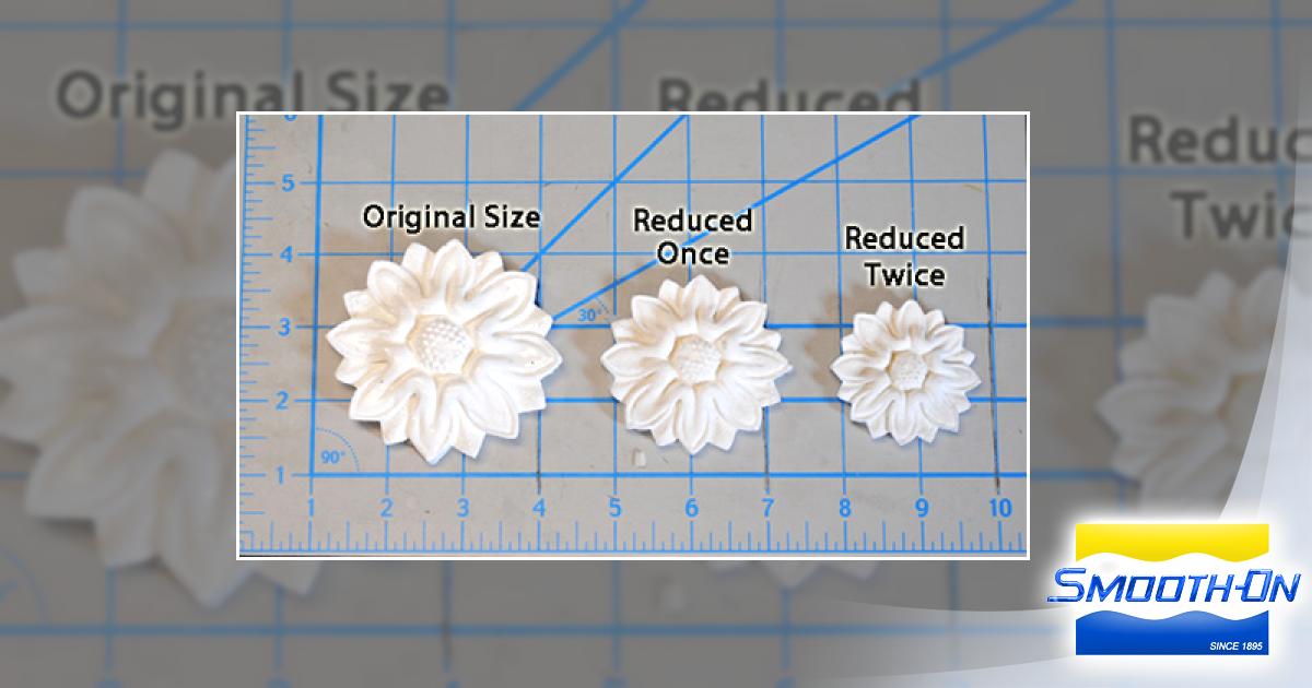

                  I think most of the head shrinkers are making a mold of the large head and shrinking the mold. Smooth on had an article about it... That means it doesn't matter what material the original head is made from...
                  • Megotastrophe
                    • Jun 29, 2018
                    • 3487
                    A user can shrink a silicone rubber mold 18% - 22% by mixing NOVOCS silicone solvent with the silicone.
