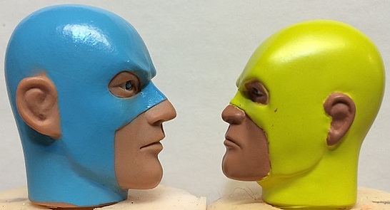

                  I bought this FTC hero head just to shrink it.
                  I submerged it for 24 hours, and then 24 hours out. Nothing.
                  Then 48 hours, and 24 out. Nothing.
                  I should have gone straight through, but I need this head shrunk down now, not in January!
                  Here's the awful balloon head next to the awesomely sized Cast-A-Way hero head:
                  He went back for another dunk into fresh Naptha just now.
                  I may have to just paint this CAW head so I can finish my project, and use this blue guy later on.
                  In the meantime, I'll just keep him in the Naptha.
