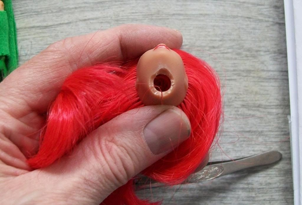

      Just a quick description - I cut off about 1/8th inch of the Mattel neck ( leave the little attachment alone, just the visible neck ) and then made a small knob, out of Sculpy, on the little part that held the Mattel head on - take a match or cigarette lighter and hit the Sculpy a flame a few time for a few seconds, this will start the hardening reaction, let it sit for a couple of days to make sure it hardens up enough. That give you the knob for a regular Mego style head. On the head I enlarged the hole a bit but in doing it hold the knife at an angle to bevel the hole downward so the Mattel neck seats into the head.

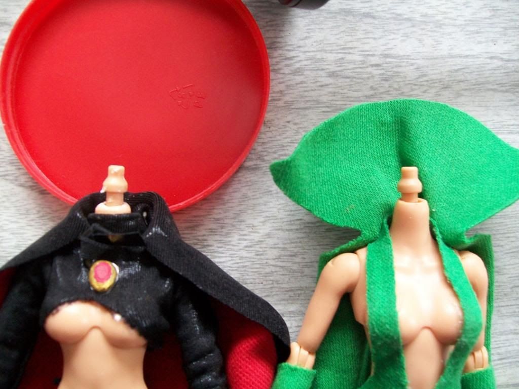

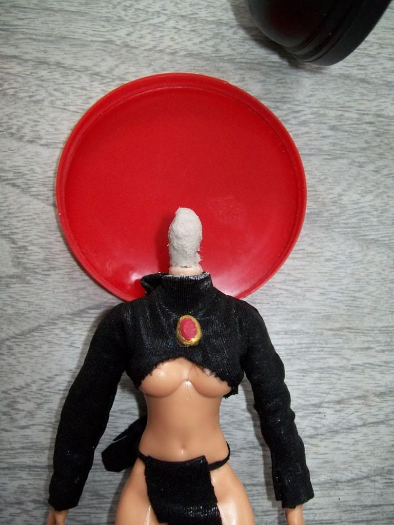

          OK here are some photos, I hope they help. When I went to pull the head off the Goblin Queen the Sculpy broke apart so I'm using air dry clay instead.
          Regular Retro neck on the right cut down on the left.
          Clay knob.
          Head hole opened slightly and angled downward so the neck can seat into it.

              Glad to help. I'll be sanding the knob down when the clay dries, it doesn't need to be to big. Also as far as shortening the neck, just lower it to a place you like without the head sitting up too high.
