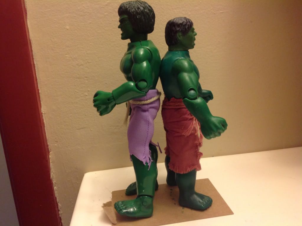

                Here's some comparison pictures.

                  Those look great, Link.
                  My only concern is the runs hence why I didn't go the fusion paint route but will try again when the weather gets warmer around here.
