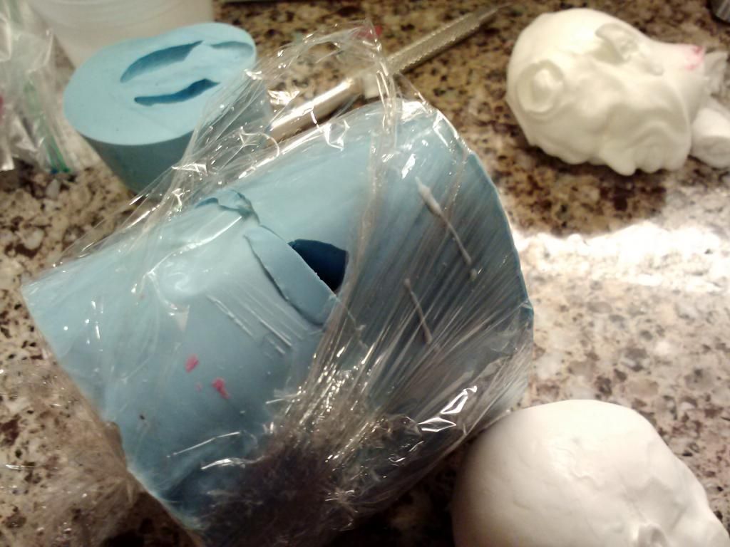

        My two part mold was secured with plastic wrap. After pouring the resin, I wrapped more plastic wrap around the mold to ensure that no plastic would leak out of the pour hole. For my spinner, I used my right arm. When I got tired, I used my left arm. I basically just kept rolling around the mold until I felt it had set. The resin is a slower cure resin, so I had about 6 minutes before it set. There is a faster resin, a 3-minute one, but I feel too pressured and end up with way too many air bubbles for my liking when I use that.

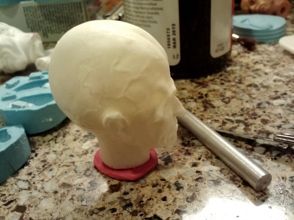

        Because my cast was hollow, I opened up another pour hole in the bottom of the neck, poured more liquid resin and capped it off with clay and stood it up to let it set. Pressure/heat was created at this stage, so the liquid resin leached out of a weak spot. I caught this in time so wiped off the liquid resin, and created another escape hole in the ear of the cast. I put additional resin in there so that customizers can drill up into the neck and find solid plastic. I don't think I would have had enough time to catch this if I had used a faster setting resin.

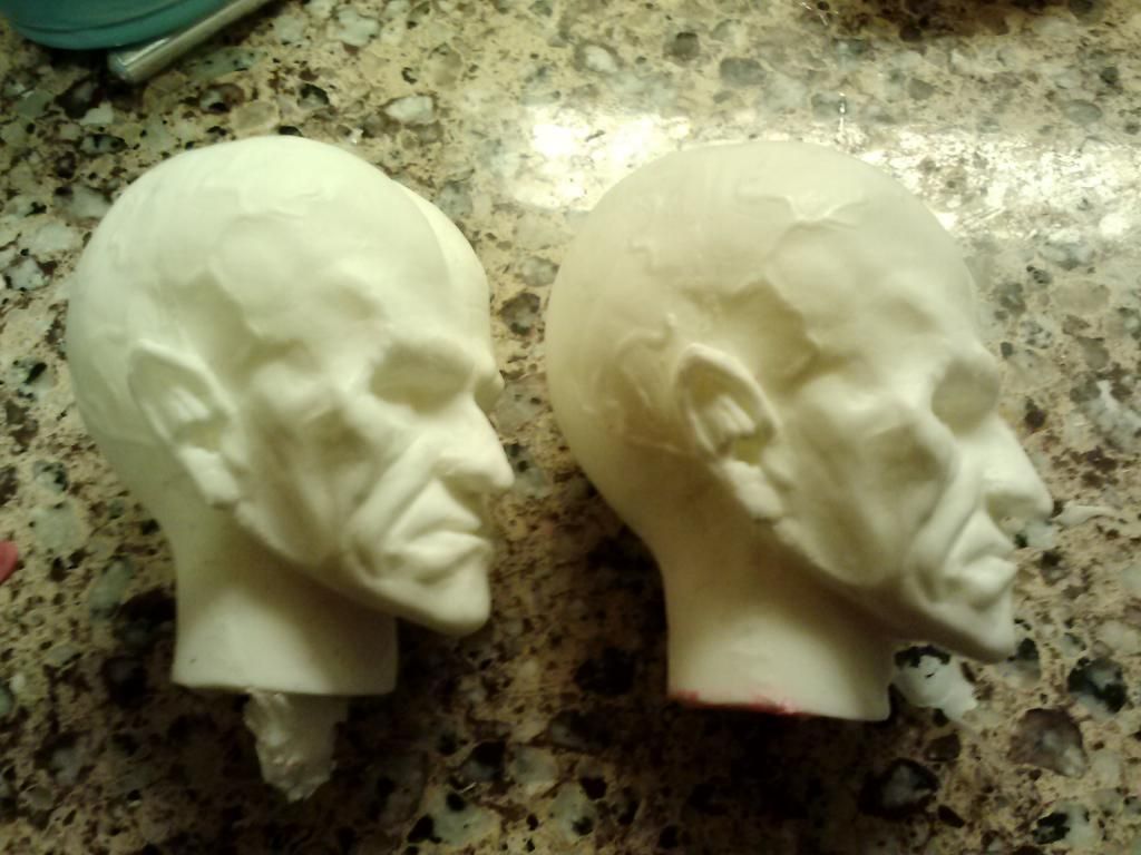

        Comparison shot of solid cast to the left and hollow cast to the right:
