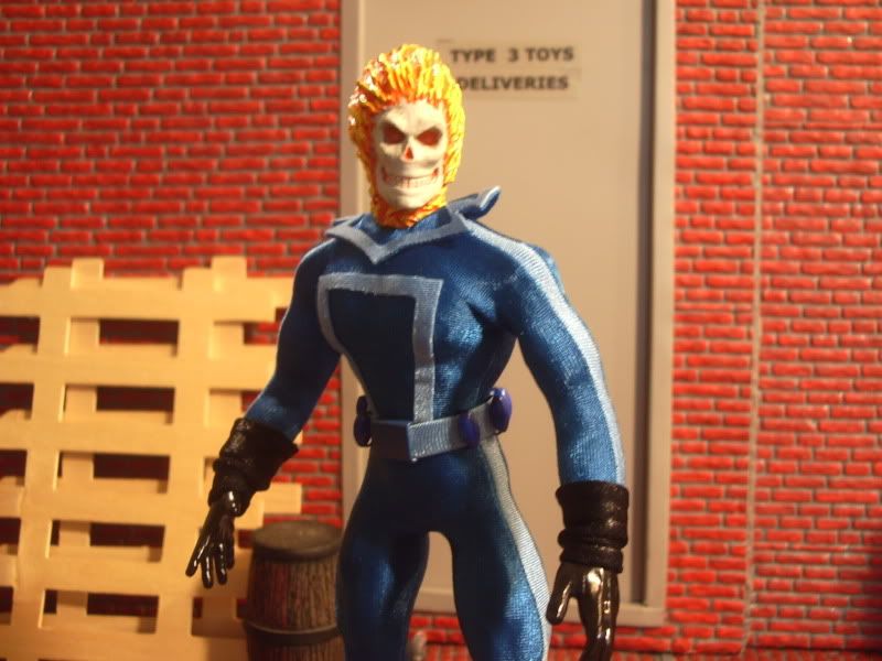

        I use a machine always. Nothing and I mean nothing comes close to a machine sewn seam. All of Ghost Riders arm and leg piping was sewn in by machine. On Spidey, the red was sewn to the blue. Also on Shocker, all maroon pipe was sewn in. As you can see(rather not see) not a single stitch is visable where the 2 colors meet each other. With even the best hand sewning, stitches would be visable giving an almost zipper like apearance.

              Originally posted by HumanWolfman
              I use a machine always. Nothing and I mean nothing comes close to a machine sewn seam. (edit) With even the best hand sewning, stitches would be visable giving an almost zipper like apearance.

              Weeeeeelllll.... Spidey & the gang there are pretty fly - So I guess good results are available with both. Mr Wolf may make me a convert yet (it would surely save me some finger joints and jabbed thumbs!)
