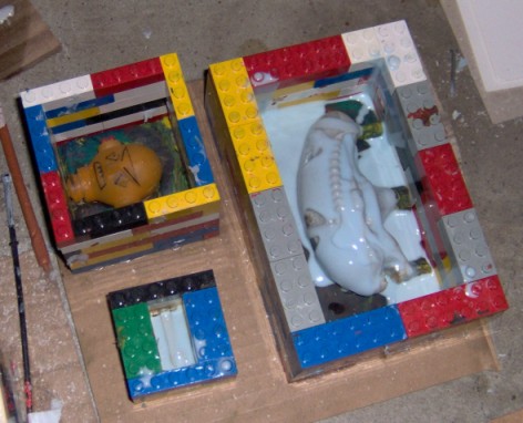

              Hmmmm....
              You guys do things WAY different from how I do it:
              These have just been started.
              I usually have ten or so on the go at any one time. I sink the original in plasticiene (NOT Play-Dough; you need something that won't dry out.) and build a lego box that fits the part. I cut the plasticiene and add air canals and guide pin holes. I then glue the lego box in place with white glue, to prevent leaks. (You'll note the molds are mounted on cardboard.) Then I pour the silicone. I pour thin coats over all the molds going: this lets air escape from the surface. Once the original is covered I usually let the silicone set, and then fill the rest of the mold. If I'm making a mold of something I only need a few of, I'll cover the original with silicone and once that's cured fill the rest with plaster of paris. (It's a LOT cheaper.) Once everything sets I flip it over, remove the plasticiene, trim the flash, coat it all with Vaseline, and pour the silicone for the second half.
              Don C.

                Don I've built many box molds. I use foam board to build mine. I only do that with larger sculpts like some of the garage kits I produce. I wouldn't use Vaseline as a mold release tho. It will eat silicone and other casting rubbers. Go old talc powder works just fine and it's cheap.
                Bob
                    I use it to keep the two halves from sticking. Once the molds are done I don't use any releaser on them.
                    Although I DO use some talcum powder to prevent air bubbles! Works really well!
                    Don C.
