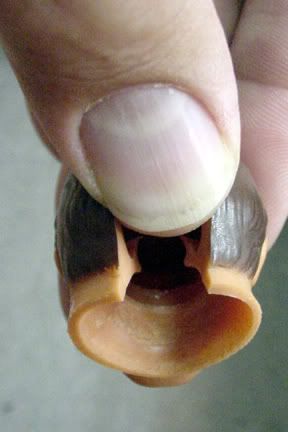

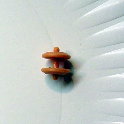

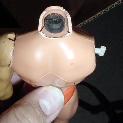

                    That's sounds right. Below are the pics I promised.
                    The back of the neck broke off while I was trying to remove the head. A bit of a happy accident. Now it's easy to see how the head attaches. At the top of the torso is a rubber stop.
                    There's a dumbell shaped piece that sits on top of the stop and into the head.
                    You can see the groove that the top of the dumbell fits into just under my thumbnail. (The head was very stiff. I had to split it open to show the detail)
                    Hey! Check out the pictures.
