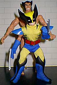

WOLVERINE
Tools you will need:
ToyBiz FC Wolverine found in most local toy stores for approx. $15.oo and dropping.
Bottle of Acetone
Large Glass
Model/hobby glue
Black, Red, and Flesh Acrylic Paint and brush
Fighting Furies Belt
MEGO head
MEGO body
 1) Gather the above mentioned items
2) Acetone, found in most hardware stores has the amazing power to shrink most vinyl pieces. Pour some of your acetone into your large glass. Start with the gloves, remove the silver claws and place one glove into the glass, it's important to have a large glass since whatever you are acetoning will double in size and is important to have the shrinking item completely submerged in the acetone or it will not shrink all over. After approx. one hour the glove will be double in size. Very carefully remove it and let it sit and begin to shrink. Do the second glove. Boots, I found the FC boots get very soft and tear very very easy. When removing from the acetone, be careful and quick do not handle them any more than necessary! The hole on the bottom of the boot will tear.. nothing you can do to prevent this. Shrinking will take 2 days to complete and it is best to keep the parts in a warm area like a garage.
 3) Pick the MEGO head you think would look best in the Wolverine cowl, I chose Hulk since he's common and has that mean looking lower face. Paint your Hulk head and or do nothing if you picked a flesh head and put it on your body.
 4) I did not like the belt that came with the FC Wolvie so I used a Fighting Furies belt that's a dead ringer for his. Paint the belt red.
 5) Put the costume on your MEGO body. I used a Wee Win MEGO knock-off Samson body, it is a tad bigger then a LionRock body and very muscular so it fills out the suit well. Pull the suit legs over the feet.
 6) When your gloves and boots are finished shrinking, glue the claws back on the gloves and re-paint the black onto the boots.
 7) Put all the parts on Wolvie and you're set.
Note: Does anyone remember when Wolverine was a runt? It seems the toy world has forgotten about that. The second Wolvie figure ever done  (ToyBiz) was in scale, all the rest have been giant. I guess even "adamantium" bones can grow!

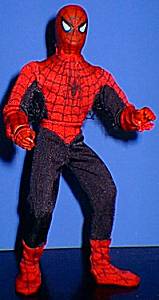

 SPIDER-MAN
   All I did for Spidey was cut the mask off the FC outfit, then I painted the web lines on a Spidey MEGO head. I added bible arms to a T2 body for added bulk to fill out the costume, then  painted the hands red and added the weblines.

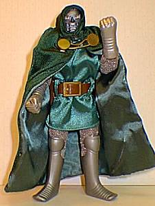

DOCTOR DOOM
ToyBiz FC Doom found in most local toystores for approx. $15.oo
X-acto knife
Hacksaw or dremel
Model/hobby glue
Small rubber band
Silver Acrylic Paint & Paint Brush
Fonzie/OMBC/ or FistFighter body
Knight Jumpsuit, 2 knight boots, and 2 ironman gloves
Ok kids this project is easy and fun.
 1) Assemble the items mentioned above.
 2) Strip down your FC Doom to his naked silver butt.
 3) Use your x-acto knife to trace an outline along the bottom of his neck. Use your dremel or hacksaw (I used the hacksaw which took less than one minute) and cut off Dooms head. It is important to include as much as his neck as possible.
 4) Use your model glue to affix the doom head onto the Fonzie or other body. It is important to have one of the bodies I mentioned since the chest piece is made out of a lighter plastic then the normal T1 and T2 bodies. If not your glue will not hold!
 5) Dress up Doom in the knight jumpsuit and add the green tunic and belt that came with him.
 6) Pull the belt tight in the back so the extra part is in a U shape then put the small rubber band (I used one that came from dental braces) around it so it will be held in place. This also will let you pull the tunic tight so it is not too baggie.
 7) Paint the IronMan gloves Silver. I got Doc MEGO gloves since they would be cheaper are easy to get and would not break my heart painting a pair of perfectly good Ironman gloves.
 8) If you are using a Fonzie body, cut of the thumbs. I found even with the thumbs in the closed position they stick out too far to get the gloves on without damage to the repro pair.
 9) Add gloves, boots, and cloak.
Enjoy your new MEGOized Doctor Doom and let his new reign of terror begin on that accursed Richards and the rest of that wretched Fantastic Four!

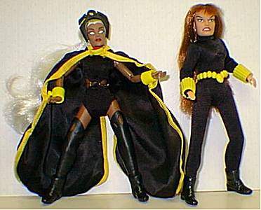

GALS STORM & BLACK WIDOW
Things needed:
Famous Covers Figures Storm and Black widow
2 female MEGO bodies: one white gal, and either Uhura or a black Dinah-mite. 4 pairs of short Dinah-mite boots, black or white (white will have to be painted black).
So easy it's silly.
1) Strip down your FC gals, which means you have to pull off there hands since both of them have bracelets.
2) Remove their heads and the heads on your MEGO gals.
3) Add heads and costumes.
Your done!
Note: I found the Storm costume needs added breast support, I used a chest piece from the Spawn Angela figure, but sculpty and/or two craft store grapes cut in half also work. Are the heads too big? Maybe, but they are approx. the same sized as their big headed sister Sue Storm.

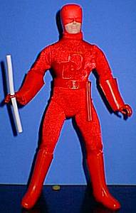

DareDevil: Just swiped the suit & club from the FC one, and thanks to Michael Gilbert I have a very mego-like Head and Belt.
