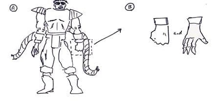

A) Here we see Dr. Octopus from the recent Toy Biz Spider Man assortment called, "Web Splashers." I picked this figure because he was in the clearance bin and had nice expressive hands. | B) Here we see my ham fisted attempt to recreate how expressive they look. I'm not the best drawer in this world when it comes to the human hand. I like a figure that has one open and one closed hand. |
